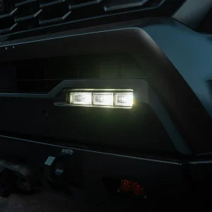

Diode Dynamics
Diode Dynamics has been around in the lighting game for quite some time building a quality light. Some of the key features to know is that they are Made in the USA using global parts, offer unique LED backlighting for this form factor, and as well as offer wide selection you can mix and match beam and color.
Price: $350 - $650
Color Options: White and Amber
Lens Options: Standard
SAE or DOT Rated (street legal): Yes
Power Output (lumens or watts): 30-40 watts, 1,140 lm - 7,920 lm
Backlighting: Optional
Warranty: Limited Lifetime
Find Them Here: https://www.diodedynamics.com/ss6-led-fog-light-kit-for-2022-2026-toyota-tundra.html

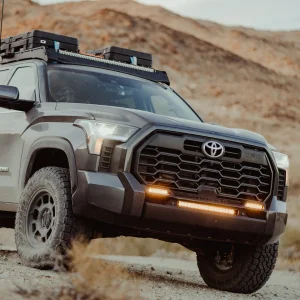

Heretic Studios
Heretic Studio sports two options for the Tundra. The first kit uses a double BA-2 Light pod that they call the Low Power Kit. The High Power Kit sports a single 6in light bar that fits in the spot. Heretic is also Made In The USA and digs in deep on the science part of lighting in their "Beyond Lumens" section.
Price: $530 - $550
Lens Options: Spot, Flood, Combo
SAE or DOT Rated (street legal): No
Power Output (lumens or watts): 413 lx - 1238 lx
Backlighting: No
Find Them Here:
Toyota Tundra (2024+) LED Fog Light Kit - Clear Lens (Low Power)
The Toyota Tundra LED Fog Light Kit is the best LED fog light kit on the market for your truck. Featuring four of our staple BA-2 Pod Lights, the Tundra clear fog light kit increases your visibility two-fold from OEM fog light kits.
www.hereticstudio.com
6
The 6-inch Amber LED Light Bar is our smallest light bar. Made in the USA, this light bar cuts through dust, fog, and low visibility conditions.

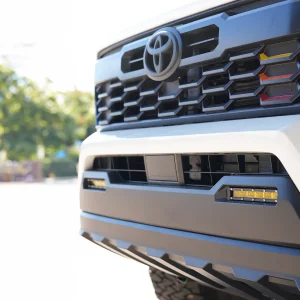

CaliRaised LED
CaliRaised LED consistently delivers a quality product at an attractive price point. You are able to read the reviews of people who have purchased the kit and they are very happy with the output of the lightings. Their product sports a single light bar and brackets that bolt right into the OEM location.
Price: $200
Power Output (lumens or watts): 7,000 Lumens
Backlighting: No
Find Them Here: https://caliraisedled.com/products/fog-light-replacement-kit-for-2022-tundra

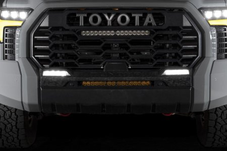

Baja Designs
Baja Designs has long track record of building high quality and high output lighting often found all over the racing scene. They offer two different kits that include their standard S2 light pods and their SAE rated light pods. From there you can also mix and match lenses types and colors for your condition.
Price: $597.95 - $669.95
Power Output (lumens or watts): 1,210 - 2245 Lumens
Backlighting: No
Find Them Here:
Standard S2 - https://www.bajadesigns.com/product...kit-toyota-2022-tundra/?vid=159031&sku=448080
SAE S2 - https://www.bajadesigns.com/product...-light-replacement-kit-toyota-2022-on-tundra/

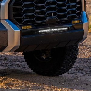

Rigid
Rigid Lights have been around in the Toyota space for some with being one of the OEM manufacture for lights on select models. Here they offer two different color options and a direct bolt in solution. The look of the lense give a very OEM+ look.
Price: $690.99
Color Options: White and Yellow
Power Output (lumens or watts): 2640 Lumens
Backlighting: No
Find Them Here:
Toyota Tundra (22+), Sequoia (23+), Tacoma (24+), 4Runner (25+) SAE Fog Light Kit
Give your fog lights an upgrade with the 2022+ Toyota Tundra SAE White Fog Light Kit. Designed to replace your Tundra's OEM Fog Lights this kit provides a street-legal lighting solution for low-visibility conditions.

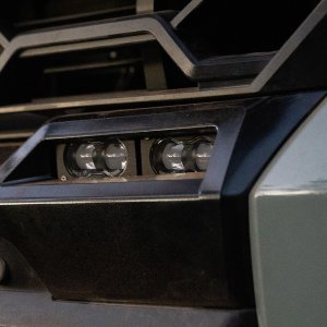

AlphaRex
AlphaRex has been building high quality lights for Toyotas for a while now. But here they offer a very special feature no one else here offers. With their "double tap" technology you are able to seamlessly swtich between white and amber lighting. Also their housing offer the most OEM fitment out of other kits.
Price: $179.10
Color Options: White and Yellow in one light
Power Output (lumens or watts): 1200 Lumens
Backlighting: No
Find Them Here:
24-25 Toyota Tacoma / 22-25 Tundra/Sequoia / 25 4Runner DoubleTap Dual
Upgrade to AlphaRex 4th gen Toyota Tacoma/3rd gen Toyota Tundra/3rd gen Toyota Sequoia/6th gen Toyota 4Runner DoubleTap Dual Color LED Projector Fog Lights and experience unparalleled visibility with 6500K white and 3000K yellow output, easily switchable with a simple on-off action. Shop now for...
