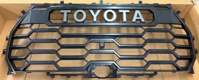

I am a sucker for all OEM parts and I am looking at swapping over to the TRD Pro Grill. There are a lot of companies that put together a lot of all in one kits together foryou to complete these task but here is the OEM part numbers.
TRD Pro Heritage Grill Insert - 53101-0C220
Grille Marker Lights - PT358-34220-AB
Grille-Mounted LED Light Bar - PT358-34220-LB
What you need to know​
  • A lot of kits online point out you need camera brackets and what not. More than likely you need to come up with a solution yourself or order the proper brackets
  • A non TRD PRO truck does not have the wiring for the running lights or front light bar. You will need an after market controller
  • To swap the grill the disassembly process is a little more involved than you may think.
