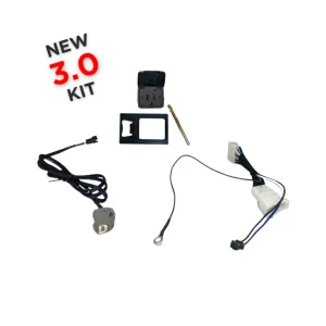

The biggest problem with the inverter in the Tundra is that it is 400w but once you start driving that drops down to around 120w. A 120w is practically useless as even my laptop uses 130w to charge. I used to have the Guild Outfitter inverter modification for my 3rd Gen Tacoma but there wasn't much documentation confirming if it would work for the Tundra but I decided to give it a try. Long story short it works and it adds and extra 12v plug to the cab!
Link: https://guildoutfitters.com/product...terior-outlet-upgrade-kit-by-guild-outfitters

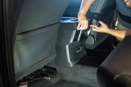

Simply pull up on the rear cup holder section and it will pop out of its clips.

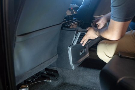

Give the rear of the center console a wiggle and th clips on the side will release. Some of the cable zip ties will need to be removed to allow the panel to be slid out of the way but I did not need to unplug anything,

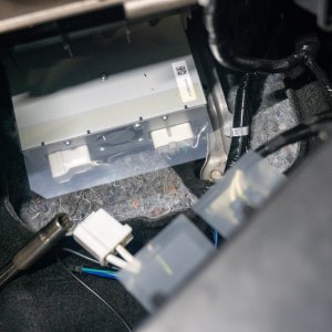

In the image above the gray box is the trucks actual inverter. The white cables in the bottom left are its main cables from the battery and the other white plugs next to that is the harness that controls when the inverter is on or off.
There is a 10mm bolt to the right of the inverter. This is the bolt you will remove and attach the ground lead from the inverter harness to.

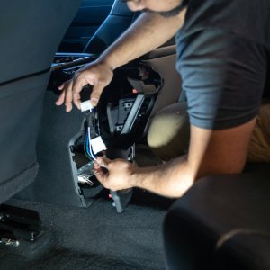

Simply unplug the control harness from the inverter and plug in this harness in-between. This will make it so the wire that detects ground so the trucks inverter will run at 400w all the time.
Before reassembling the truck simply test by turning on the truck, then the inverter, and putting the truck into gear and the inverter light on the desk should stay orange.
Step 4: Installing the Harness
