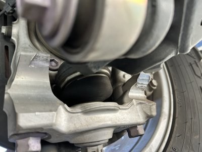

Went to do some adjustments on my suspension and noticed my lower knuckles on both sides have displaced metal on them.
Has anyone else seen this on there’s? Has anyone swapped to the TRD pro knuckles to fix this?
Oh ya that is bad. Are you rubbing on anything?
After some research, this is more common than not. When you lift your tundra over 2.5” the turning angle changes and puts your lower knuckle in a lower position. The TRD 3” lift kit comes with longer and taller lower knuckles and fixes this issue. I just changed these out yesterday and it looks way better, and I got my full steering range back.
View attachment 2427View attachment 2428
Dude this is good to know!!
