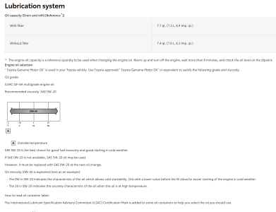

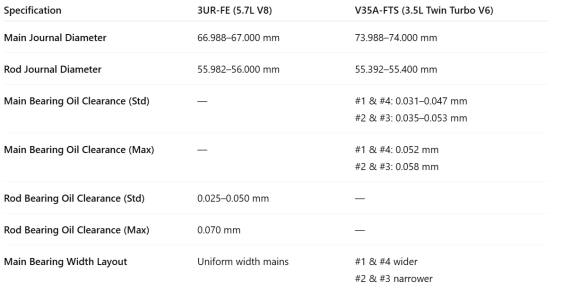

When comparing the two motors when comes to bearing tolerance and more the 5.7 V8 has smaller tolerance gaps. Also when you reference the Toyota Online Owners manual for the 2021 Tundra is specifically calls for 0w-20 oil.

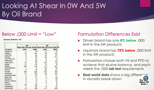

5w-30 oil provides better protection​

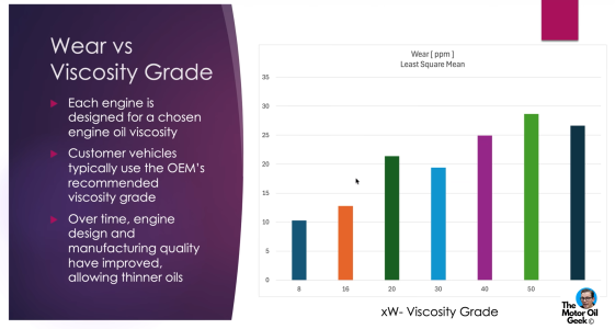

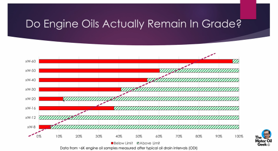

Looking at the data above they tested oil by brand and weight using the J300 lab testing. This test to see how the oil breaks down over time. There is a grading system to oil and because of use once and oil falls out of grade it will produce more wear than when it was new.
When comparing the list it shows how many oils in the 0w category from that we can see by brand how many oils in that category pass after the test compared to those in the 5w category. In reviewing this data it is not oil weight that is more important in fact you should the weight the manufacture designed the engine for. But it is more important to choose an oil that is able to stay inside grade to protect the motor.

For Tundra on US soil, using US oil, and US fuels they recommend 0w-20 oils. So the conclusion is that Toyota has refined their engineering to accept these oils and utilize them fully in the proper manner.
