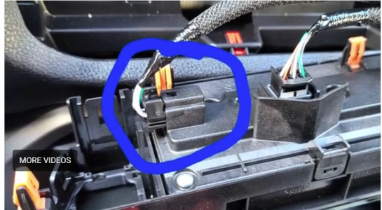

In your research, have you seen or know the part number for the harness to the knob? I looked today and I do not have the harness into the dummy plug as mentioned in the video. Thanks

Do you have any photos? I found this on using my Toyota manual bot
If you bought the 14 inch screen (86100-0C360) and the switch and volume assembly (86170-0C010) but you are missing the small plug that goes into the volume assembly, Toyota sells the connector parts. You essentially build the pigtail yourself (or buy a pre made pigtail from an aftermarket seller).

Here are some photos of what I have. I have not bought head unit yet, since I want to make sure I can get the knob to work. My truck is non JBL. It would be great to have a pre made harness if possible, just to reduce any wire splicing.
Do you have this harness behind you HVAC controls that is supposed to plug into it? Or are we trying to find an additional harness to make it work? Sorry I just need a little clarification.
I checked and I do not have the harness behind my HVAC panel. There is nothing in the dummy plug. Thank you.
