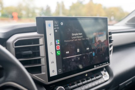

When I was shopping for my truck one of the things I didn't settle on was wanting the 14in screen. BUT, I was still looking at SR5 packages that only had the 8in screen because I found out you can swap out the screen.
NOW! I am not talking about some after market android base screen that doesn't implement well with the truck. To my surprise a OEM Toyota 14in screen is plug and play into the truck. The screens are not VIN tied or need to be unlocked or reprogram. They just plug in. But there is a catch to that. If you truck did not come with the 14 in screen it does not have the volume knob on the dash. Now the steering wheel buttons DO work and you can modify the dash. Lets get into it.

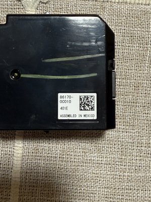

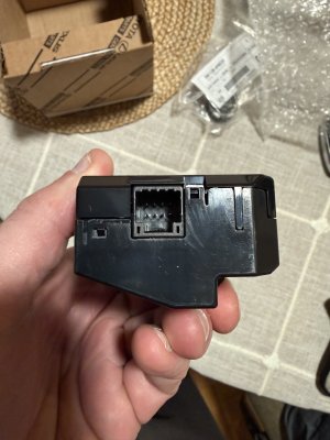

Switch and Volume Assembly - 86170-0C010

- The screen is easiest found on Ebay for around $800. Make sure you pay attached to JBL vs no JBL depending on what you have inside of your truck. Also you want to make sure you get one with the vents on the side. If not you need to modify you existing vents which isn't fun this makes it even more plug an play.
- You can simply remove the dash assembly where the volume knob is supposed to be. You are able to use a step bit like in the video to add the volume knob and switch and the wiring is already there. People even say there is a marking were you need to drill.
- Also please if you do there add your photos below. Also check to make sure it all turns on before putting the dash back together.
